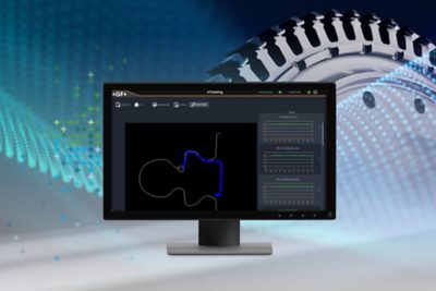

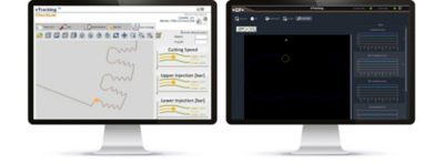

Monitor live machining process information with a 2D real-time graphic view where tolerances are controlled.
Productivity optimization
Machining data is sent every second and the machining behavior is corrected and adapted.
Proven traceability
Analysis reports are generated to define maintenance tasks and final records are produced for traceability and statistical assessment.

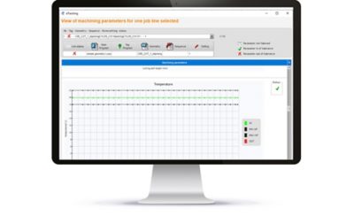

REALTIME RECORDING: During part execution the system records all defined signals Limited signal
REALTIME TOLERANCE CHECK: During part execution the system monitors the deviations based on the tolerances defined for each signal Limited signal
REALTIME MACHINE STOP: Suspend machine execution in case of tolerance deviation
REALTIME HISTORICAL VISUALIZATION: During part execution the system displays in a 2D graph the recorded signals behavior and the related tolerances
