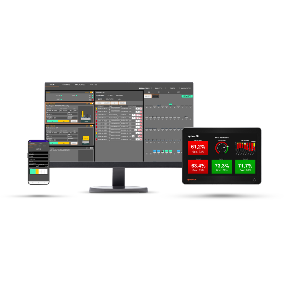

System 3R WorkShopManager
Automation for increased competitiveness
To stay competitive, manufacturers must be able to keep up. Palletisation is a major element in success; automation is essential for competitiveness. With System 3R as your partner, taking the step to automating and streamlining production is far easier than is often imagined.
The steps are simple. You input the data (workpiece, fixture, NC programs, tooling, materials, etc.). Then, based on current orders, WSM 5 (WorkShopManager 5) shares it with your machine tools and stores all the information in one place.
Boosting Production Efficiency
  • WSM 5 optimises and schedules whatever your production environment involves (stand-alone machines, inspections, quality assurance, etc.).
  • Control of your manufacturing processes is seamless and real-time. Visibility of your stand-alone and automated operations is guaranteed.
  • Automated and non-automated work cells are seamlessly integrated into a smooth production flow.
